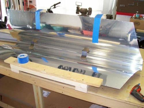

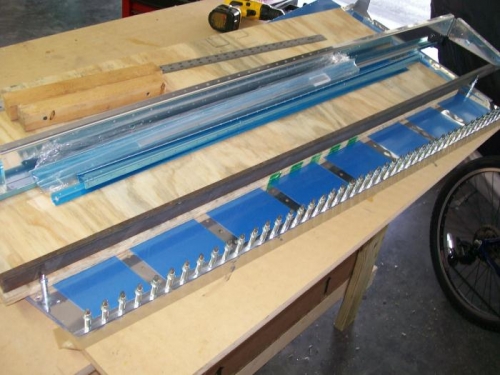

Today I drilled the rudder trailing edge to the table and glued with tank sealer. While this was drying for two days I started the Right elevator. Match drilled stiffeners and all skeleton parts. Deburred, dimpled and primed the skin and stiffeners.
Elevator skin deburred and dimpled
Elevator parts deburred, dimpled and primed
rudder is clecoed to the talbe after gluing
