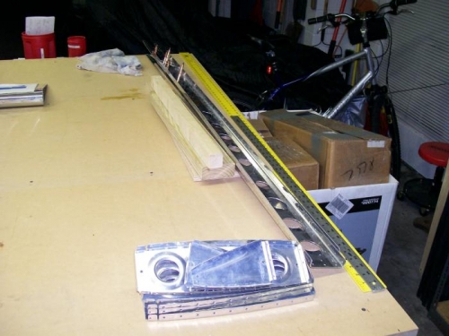

Brief Description:  Match drilling, deburring & dimpling

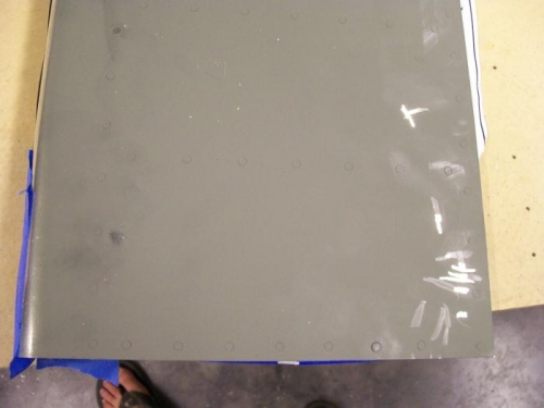

Not much time tonight. I had the left HS assembly together for match drilling skin. After drilling I pulled it all back apart. I deburred the ribs and dimpled. I ahd primed my practice piece yesterday. I checked it by scratching with my fingernail. I was very disappointed. Even after 24 hours, it scrapped off very easily. Tonight i used two other brands for testing. I was much happier with the results from both of these. I used Shewin Williams gray and Duplicolor green. I will see which one does better tomorrow.
Rust-Oleom didn't do very well.
SW on the left and Dupli-Color on the right
