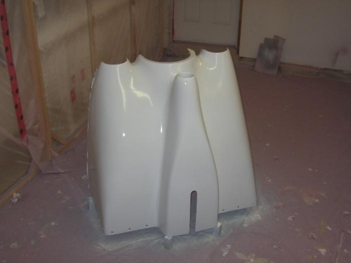

Lower engine cowling painted

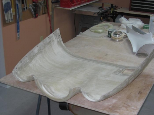

Upper engine cowling sanded after the second micro application
