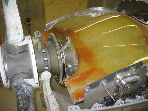

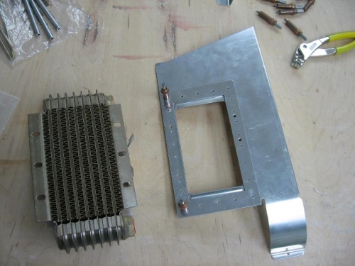

I started the day by bonding and riveting the cowling horizontal split line quarter turn fastener retainer strips. Next I fitted the lower cowling on the firewall so I could fit the engine cooling plenum, positining the plenum to align with the cowling engine cooling air intake. With the position of the plenum figured out I determined the height of the oil cooler on the engine aft left baffle and prepared the baffle for the oil cooler installation.

Engine cooling plenum fitted
Aft left engine baffle prepared for the oil cooler installation
