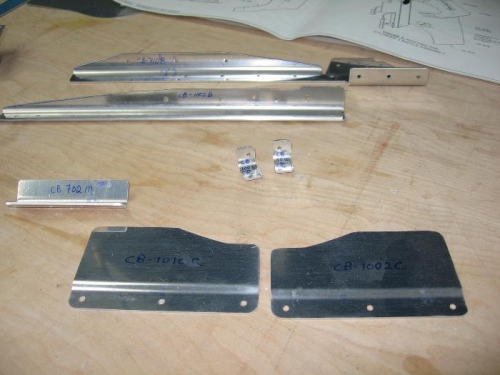

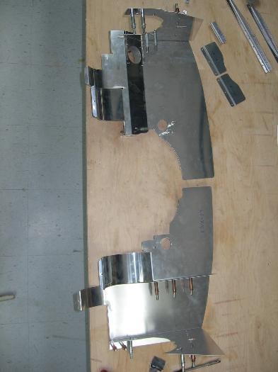

Brief Description:  Engine baffle preparation
Today I pulled the engine baffle kit out of storage. I prepared the engine aft baffles and aft side baffles by match drilling them together with each other and with the stiffeners and doublers that attach as per the drawings. Then I disassembled, deburred, edge finished and dimpled the various parts as called out.
Engine rear baffles and aft side baffles
Baffle stiffeners and doublers
