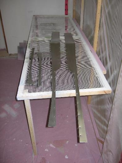

I had as yet not addressed the painting of the wing to body fairings and the HS to body fairings so I pulled them off the shelf, cleaned, etched and abraded them. I then placed them in the spray booth for drying prior to priming. Next I sanded the main gear leg upper intersection fairings and also the inner face of the lower engine cowl. Once sanding was completed I mixed micro, applied it to the intersection fairings and began a second application of micro on the engine cowl.
Wing to body and HS to body fairings cleaned, etched and abraded

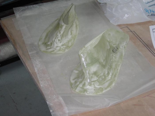

Main gear upper intersection fairings sanded and micro applied

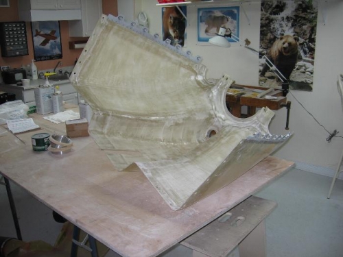

Lower engine cowl inner face sanded and a second micro application started
