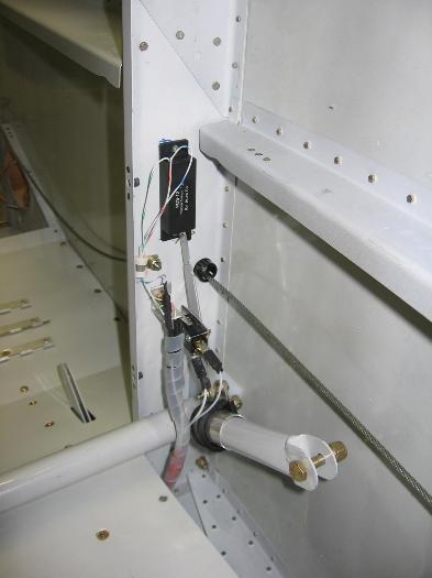

Today was a marathon work session. I started by wiring the AOA system flaps not up switch. Then I secured the flap drive motor wiring and installed a molex connector. Next I ran wiring for lighting for the baggage compartment and the electrical equipment compartment. Then I did a general wiring harness securing and tying especially in the elevator push tube tunnel under the cabin floor area. Following this I reinstalled the cabin and baggage area flooring I had removed to route wiring in the elevator push tube tunnel. Lastly I hooked up the wiring for the lighting for the baggage compartment and electrical equipment compartment and tested out the circuit. Everything was working well so I added clamps here and there to secure the wiring and ensure proper clearance between the wiring and structure so no wires would chafe.
AOA flaps not up switch wired
