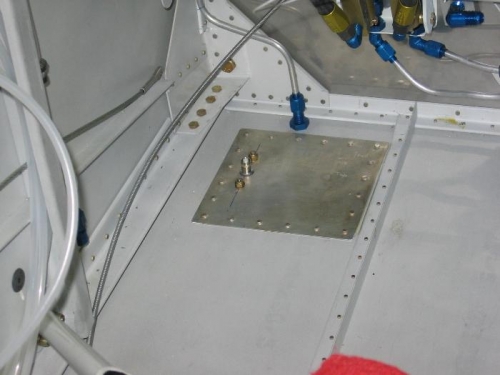

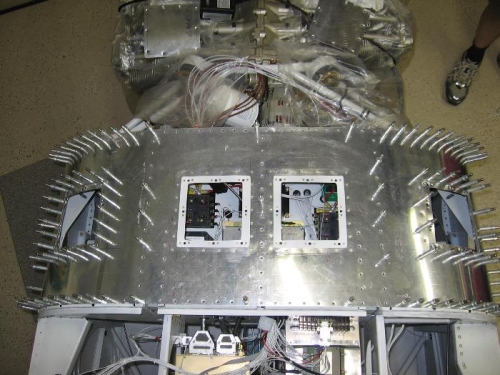

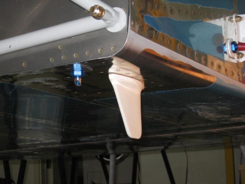

My brother Bernie was available to assist so we fabricated the transponder antenna doubler plate, riveted it on and installed the antenna. I decided that additional fuselage forward upper deck access panels would be beneficial so we cut two more openings, fabricated back up rings and access panels and match drilled everything to the fuselage forward upper deck.
Transponder antenna doubler plate installed
Transponder antenna installed
Fuselage forward upper deck access panels added
