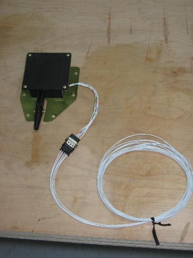

Brief Description:  Ray Allen trim servo wiring connector
In trying to figure out how to connect all those little wires of the Ray Allen aileron and elevator trim servos I turned to Bob Nuckolls "How to Articles", found at Aeroelectric.com Articles Bob describes trimming a D-sub connector down to the bare bones, encapsulating the wires with Shoe Goo and then heat shrinking the two D-sub connector halves together. I tried it first on the elevator trim servo wiring.
Ray Allen elevator trim servo wiring harness connector fabricated
