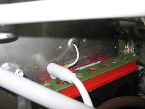

Hot battery buss cable connected

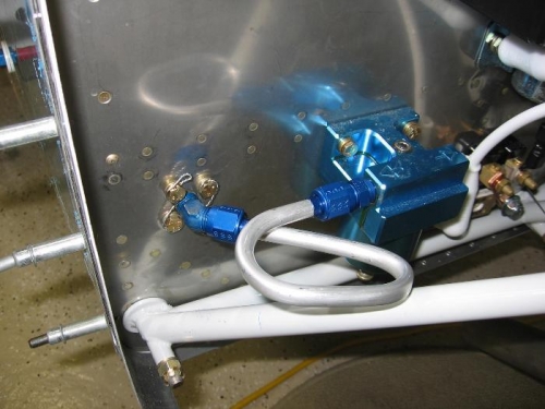

Tubing from the gascolator to the fuel flow transducer installed

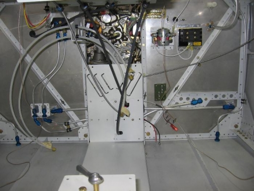

Forward cabin cover fitted with relief for the engine control cables
