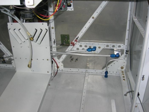

Brief Description:  Engine fuel flow transducer mounting
I started the day by drilling the fuel flow tranducer retaining bolt holes in the mount that I fabricated and then riveting on anchor nuts. Following this I completed fabricating the AN fitting mounting blocks for the firewall pass through for the fuel lines. Next I drilled and bolted the mounting blocks to the firewall. Finally I installed the AN fittings on the right hand mounting block and fabricated and installed the fuel line upstream of the fuel flow transducer.
Fuel flow transducer mounted inside forward cabin cover
Fuel line installed upstream of fuel flow transducer
