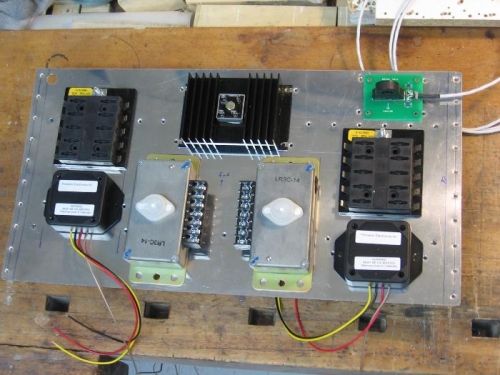

Brief Description:  Electrical system component mount fabricated
I was trying to figure out where to mount my busses, regulators, essential buss diode, capacitance fuel quantity adapters and current transformer for the electrical system. I still had some "trim bundle" sheet aluminium from one of Van's airframe kits and some "J" channel from the fuselage kit so I fabricated a mount tray. It will mount just forward of the subpanel directly below the access panels I fabricated on the forward upper fuselage skin.
