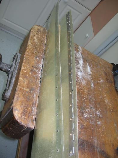

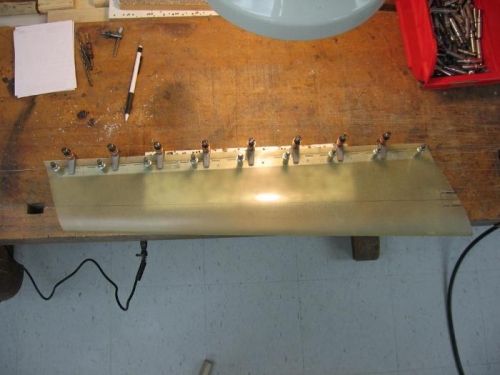

Today I started the day by cutting the slots in the gear leg fairing used to clamp the fairing to the gear leg. Then I match drilled the gear leg fairings to the gear leg fairing hinges. Lastly I countersunk the fairings and riveted the hinges on.
Gear leg fairing match drilled to the fairing hinges
Gear leg fairing countersunk and fairing hinges riveted on
