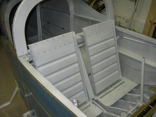

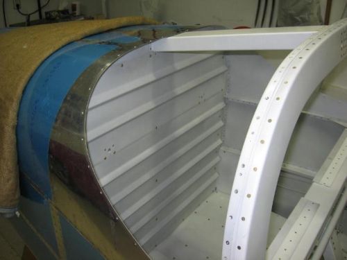

Brief Description:  Floor, baggage bulkhead and seat back installation
I started the day by completing the cabin floor panel installation that had not been done. I switched to installing clamping for the static pressure line aft of the baggage bulkhead. Next I riveted the aft flange of the F-732 channel to the F-706 bulkhead. Then I investigated and corrected an elevator push tube to F-705 bulkhead cutout interference. With that complete I turned to the seat back installation. I slight trim of the seat back bace was required to clear the roll over bar. Lastly I trial fit the aft baggage bulkhead cover.
Installing clamping for the static pressure line
Seat backs trial fit
Trial fitting of the aft baggage bulkhead cover
