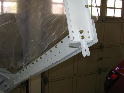

Brief Description:  Canopy latch installation continued
Today I started by riveting the canopy side rail end angle to the canopy aft channel. Then I match drilled and bolted the Wd-622 canopy latch lugs to the frame. Lastly I reassembled the canopy side latch mechanism and carried out several more iterations before smooth reliable operation was achieved.
Wd-622 canopy latch lugs installed
Canopy side latch installation and adjustment
