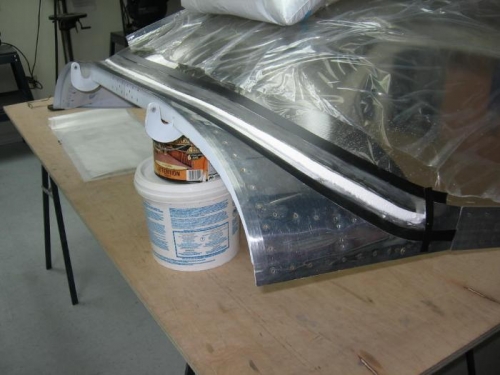

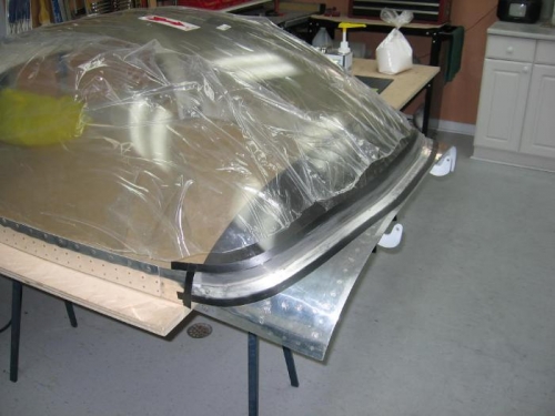

Brief Description:  Canopy to forward skin fiberglassing
I continued on the canopy work. I taped off the area to be fiberglassed and abraded the plexiglass and skin. Then I microballooned the interface between the plexiglass and forward skin. I finished by fiberglassing the plexiglass to the skin and applying peel ply.
Taping off area to be fiberglassed and abrading the surface
Microballooning the interface
Fiberglassing the canopy
