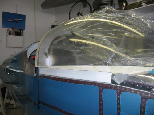

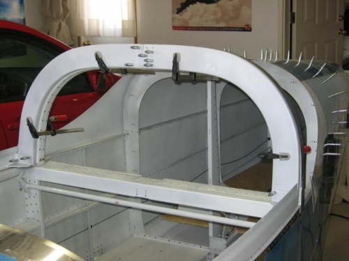

My brother Bernie and I put the canopy back on the fuselage today and marked the trim line along the Wd-725 side rail then removed it and did the trim. Then we reinstalled it again and adjusted the position of the F-631A aft canopy frame to contact the canopy, reclamped it and match drilled that half of the F-631A splice plate that had thus far not been drilled.
Canopy trimmed along the Wd-725 side rail
F-631A canopy aft frame repositioned to contact the canopy and splice plate match drilled
