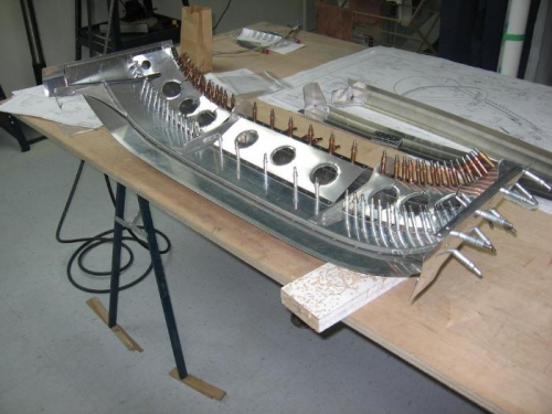

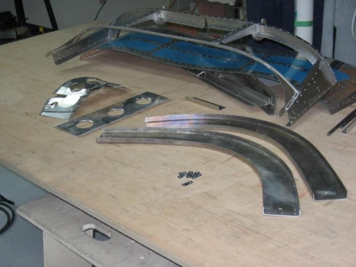

Today I match drilled the F-7128 canopy skin reinforcement braces to the C-702 canopy skin. Then I fabricated the F-7128C clasps and match drilled them to the braces. Once compete I disassembled everything and carried out deburring, edge finishing, dimpling and countersinking as required.
F-7128 canopy skin reinforcement brace match drilled

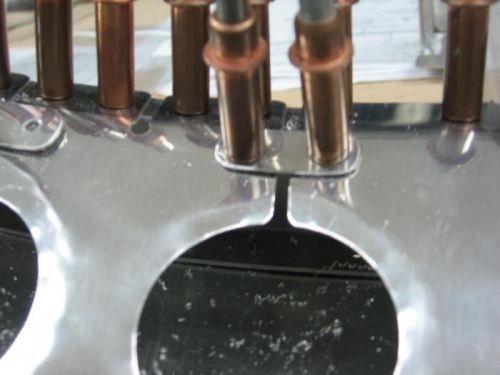

F-7128 reinforcement brace clasps match drilled
Canopy parts deburred, edge finished, dimpled or countersunk
