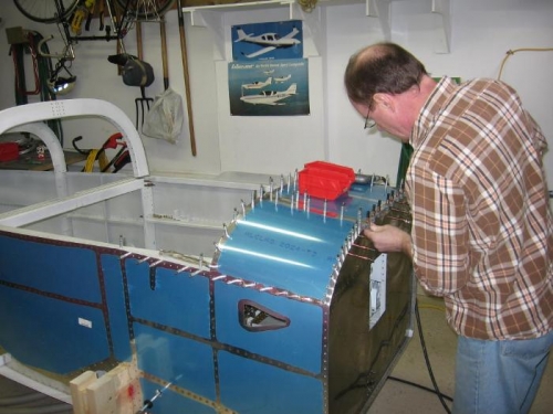

Today my brother Bernie and I installed the forward fuselage upper sub structure and then installed and match drilled the F-771 forward upper skin. Following this we installed the angles securing the instument panel to the forward canopy deck. We finished the day by fabricating the angles securing the fresh air vents to the forward side skin and match drilling the angles to the forward side skin with the vents in position.
F-771 forward top skin match drilling

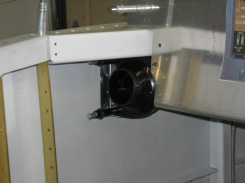

Fresh air vent installed
