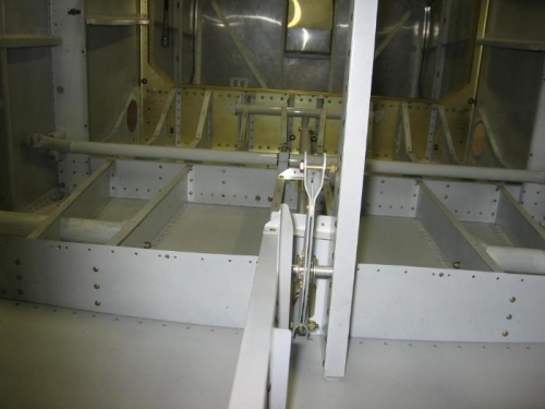

Brief Description:  Elevator control rod installation
I read on Dan Checkoway's site about difficulties installing the elevator control rod through the tunnel. The rod is somewhat too long. I removed the rod ends and flexed the tube slightly to get it to fit. Then I reattached the rod ends and secured it to the control tube at the F-704 bulkhead and the bellcrank at the F-706 bulkhead.
