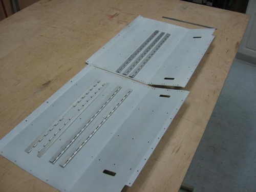

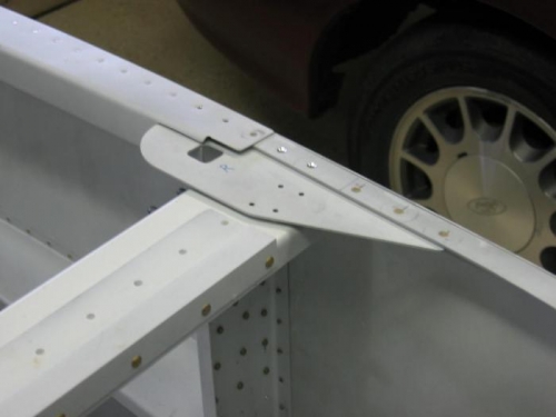

I started today by riveting in the F-757T plates to the F-718 main longeron at the F-705 bulkhead. These act like a gusset but also accommodates the canopy latches. Then I marked the F-742 seat bottom panels for the location of the seat back attaching hinge locations and also cut the six hinges to length.
F-757T riveted to the F-718 longeron
F-742 seat bottom panels marked and hinges trimmed
