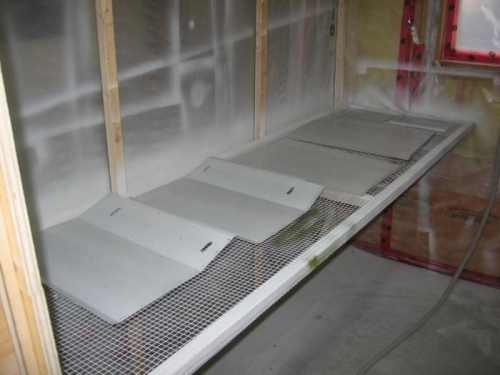

Brief Description:  Priming cabin and baggage area parts...
I began the day by priming all the cabin and baggage area parts I had cleaned, abraded and alodined the day before. While the parts were drying I match drilled the F-636 shoulder harness anchors to the F-718 longeron as well as the F-656 gussets that reinforce the F-706 and F-707 bulkheads. Once the primer was dry I riveted the F-695 forward fusleage gussets to the F-718 longeron and firewall angle.
Primed cabin and baggage area floor panels
