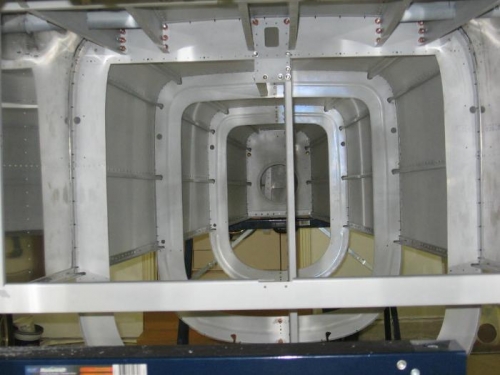

Brief Description:  F-770 forward side skin bending
My brother Bernie came early this Saturday. We started by completing the riveting of the aft fuselage assembly. Then we moved on to the bending of the lower aft corner of the F-770 forward side skin. With the F-770 clecoed back in place after bending the lower aft corner we worked on getting the left and right steps fitted and drilled to the F-770 forward side skins. Once that was completed we clamped the F-718 longeron to the foward and aft side skins and match drilled the F-718 longeron to the side skins.
F-770 forward side skin and step installation
F-770 & F-773 side skins match drilled to the F-718 longeron
