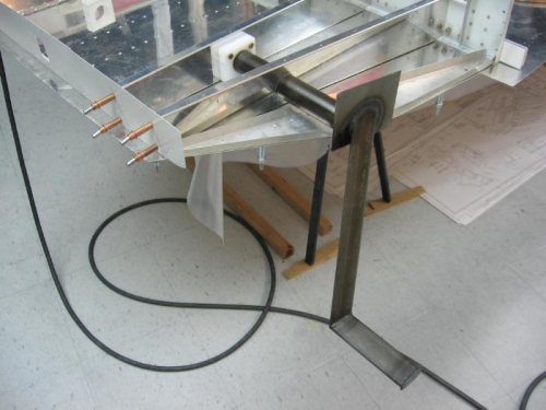

Brief Description:  Cleaning and alodining fuselage center section par
I started the day by working on the fuselage step installation. The F-723 rib flanges needed to be scallopped to allow for step tube clearance and the UHMW blocks had to be drilled and fitted to the baggage floor rib, see image 1. After that was complete I cleaned, abraded and alodined the fuselage center section ribs and skin, see image 2.
Right hand step installation
Cleaned, abraded and alodined parts
