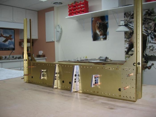

Date:  6-2-2007
Number of Hours:  8.25
Manual Reference:  8-2
Brief Description:  F-704 Center Section Bulkhead Preparation
My brother Bernie came over and together we prepared the F-704 bulkheads by enlarging numerous holes for bushing installation for wiring, drilled the F-704 shears bars to the F-704B, fabricated the F-633 control column mounts and fitted them to the F-704B, attached all the nut plates to the F-704A & B upper flanges and finally we prepared and mounted the F-782 and F-783 cover support ribs to the forward face of the F-704A.
Center Section Bulkheads
