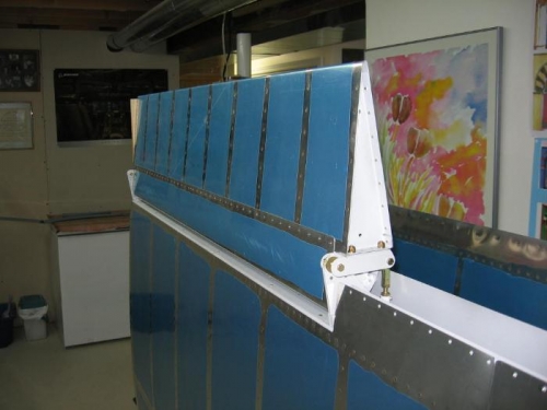

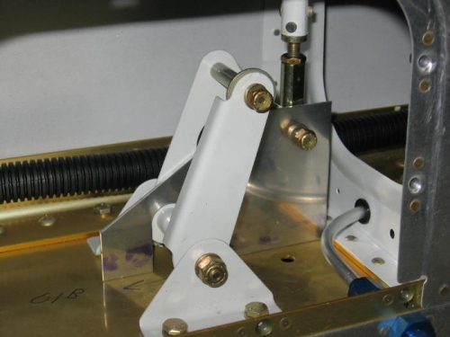

I started the day by installing the brackets that bolt to the fuselage and provide support to the forward inboard corner of the fuel tank. Then I installed the aileron hinge brackets on both ailerons and installed the left aileron on the wing hinge brackets. Then I installed the aileron bellcrank rig board and the wing tip rib rig board and adjusted the fore and aft aileron push tube to the correct length for the aileron neurtal rig position.
Fuselage to fuel tank support bracket installed
Left aileron installation
Aileron bellcrack neutral rig board installed
