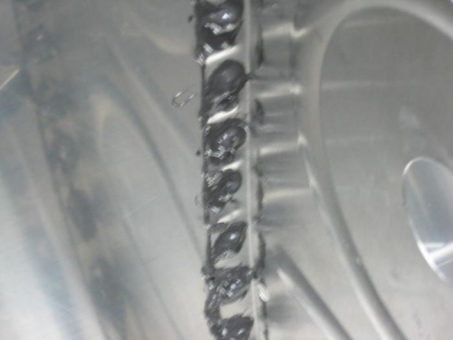

Left wing tank sealing
I pressure checked the right wing fuel tank and found a leak at the BNC connector. I opened the tank access panel and added some more sealant over the connector. Then I proceeded to dab all the rivet shop heads on the left tank.
