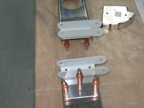

I edge finished both aileron spars, made the spar reinforcement plates from stock material and match drilled the reinforement plates to the spar then clecoed on the hinge brackets in preparation for drilling the attachment bolts.
