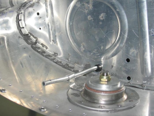

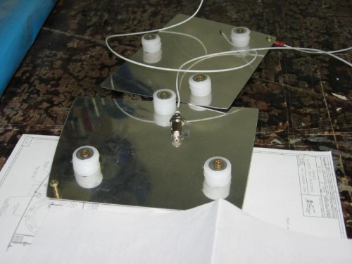

The fuel tank still requires the fuel vent line, fuel quantity capacitance plates and fuel pickup tube installed. I trial fit the vent line and flared the inboard end for the AN fitting installation, see image 1. Then I trial assembled the parts for the fuel pickup tube including the anti-rotation bracket, see image 2. I also installed all the fuel quantity capacitance plate mounting hardware as a trial, see image 3. Lastly I drilled, deburred and edge finished the tank outboard bulkhead reinforcement plate that is mounted to the bulkhead nose.
