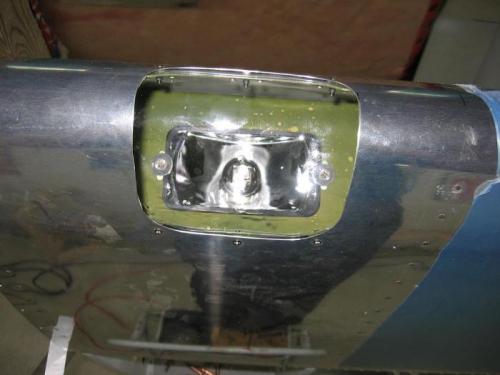

Brief Description:  Landing light installation
I completed the right wing landing light installation by drilling the leading edge lens holes to final size, deburring and dimpling them. I attached plate nuts to the lens retainers, installed the light assembly in the leading edge bracket, installed the bracket in the wing leading edge and fastened on the lens.
