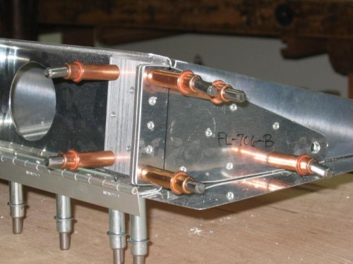

Brief Description:  Flap actuation input rod attach plate and angle
On the inboard end of the flap where the flap actuation control rod attaches the end rib and spar have a plate and angle attached for greater strength. After manufacturing the angle from stock and bending the plate to the required 6.3 degrees in Saturday's session I positioned and match drilled the angle and plate to the spar and end rib. I also drilled the plate for the control rod attachment anchor nut, see image 1.
