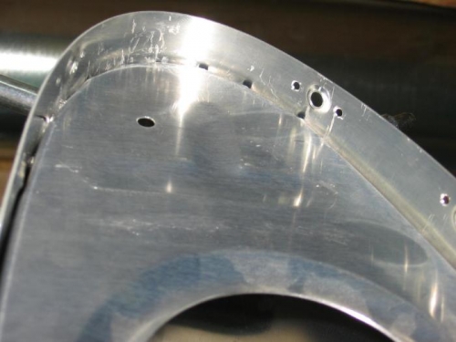

Brief Description:  Deburring, dimpling and edge finishing

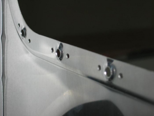

I final drilled the holes for the right wing lower surface access panels and panel wing skin cutouts, deburred the holes and dimpled the panels and panel cutouts, see image 1. Then I final drilled the wing leading edge to fuel tank joint plate plate nut attaching holes, deburred the holes and dimpled the screw holes, see image 2. Finally I deburred the right wing upper surface skins and edge finished them.
