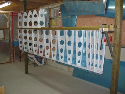

Brief Description:  Wing assembly fixture work

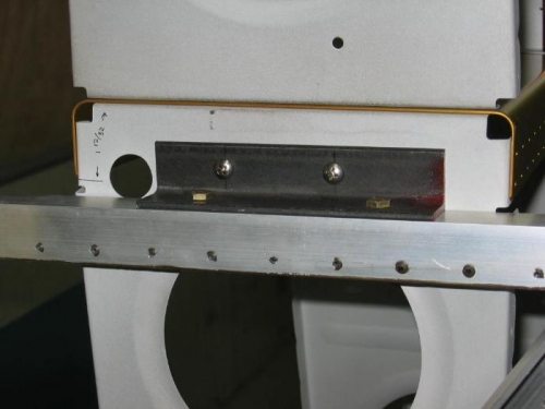

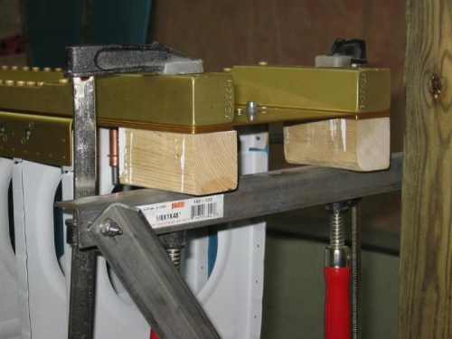

Today I did some more work to mount the right wing on the assembly fixture. The main end rib has to have an additional hole drilled into it beside the tooling hole that already exists. Then a piece of angle is attached to the main rib which is in turn attached to the support bracket on the post. This is on the far side of image 1. Image 2 is a close up of the far side of image 1. Image 3 is the near side of image 1, the inboard end of the wing.
