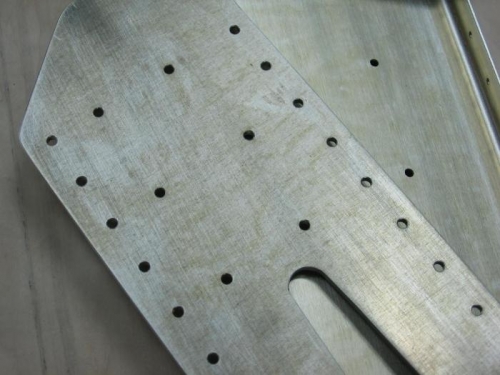

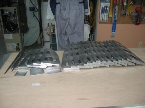

All right wing ribs, aft spar and aft spar doublers were cleaned, abraded with scotch brite, dried and then alodined. Image 1 is the ply of components air drying after being dried with a clean cloth. Image 2 is one of the aft spar doublers with the alodine anti-corrosion treatment completed.
