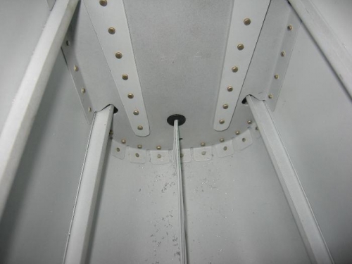

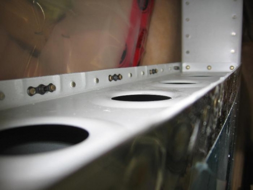

Picking up where I left off yesterday I drilled the next two bulkheads forward of the aft most bulkhead, deburred the holes, installed grommets and routed the aft nav and strobe light wires through all the bulkheads. Then I reinstalled the horizontal to vertical stabilizer fairing, sanded the reglassing and filling I had done last week and drilled the retaining screw holes to final size. Next I removed the fairing and both stabilizers and drilled, deburred and riveted the fairing retaining screw nut plates to the stabilizers.
Aft bulheads drilled, grommets installed, nav and strobe light wiring routed
Horizontal to vertical stabilizer fairing holes drilled to final size
Horizontal to vertical stabilizer fairing retaining screw nut plates installed
