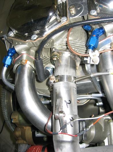

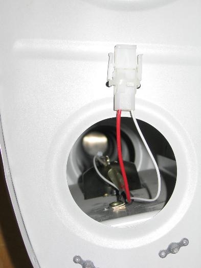

Today I decided to add molex connectors to the taxi and landing light installations to be able to quickly remove the wing tip fairings or light assemblies if needed. I also added clamps to secure the wiring. Another job that was on my "to do" list for a while was to remove the exhaust pipes at the cylinder exit and debur from the inside the EGT probe hole that was drilled. Also the #1 cylinder had had the EGT probe hole drilled in a bad spot so it interfered with the ignition plug so I packaged up that pipe and sent it to Larry Vetterman to get fixed up.
Molex connectors and clamps added to landing and taxi light harness
Exhaust pipe removed, EGT probe hole deburred and pipe reinstalled
