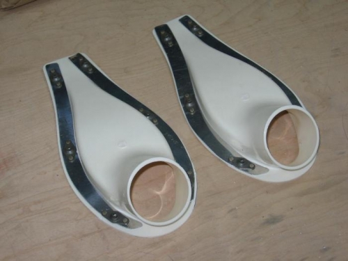

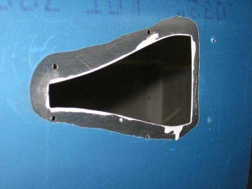

Today I fabricated anchor nut retainer straps and riveted them to the fresh air vent NACA scoops as well as match drilling the NACA scoop openings to the NACA scoops.
NACA scoops with anchor nut straps
NACA scoop openings match drilled
