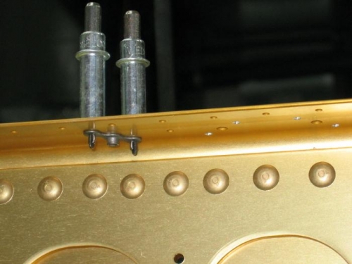

Wing Main Spar Flange preparation
Study the plans for the wing main spar flange anchor nut installation. Drill, debur and countersink the anchor nut rivet holes
