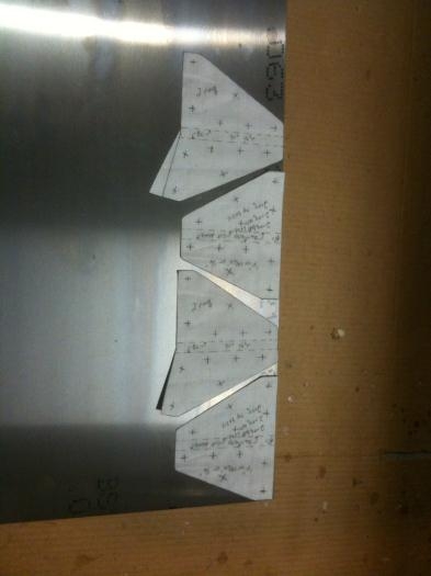

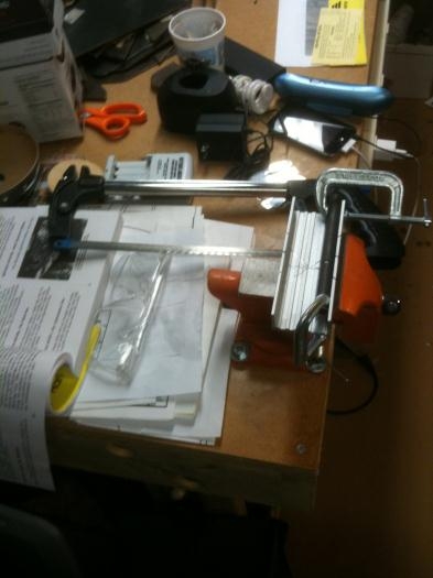

Cut the tubes for the engine mount brackets and prepped the templates to trace the brackets on the .063" 4130 sheet. The tubes are cut long until the firewall is installed, then they will be cut flush.
Cutting tubing.
Cutting tubing.
Upper bracket tube, cut oversize on purpose.
Bracket patterns ready to be adhered to the steel for cutting.
