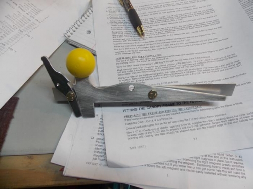

Brief Description:  canopy latch

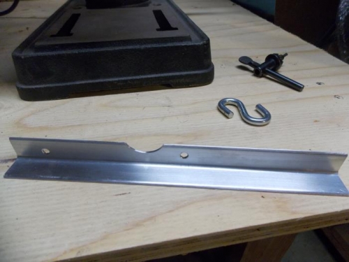

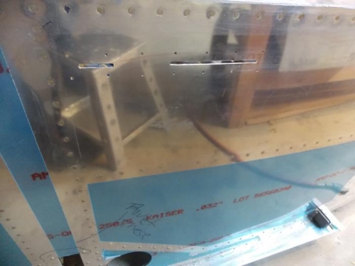

I cut and filed the canopy slots. I stole an idea from another builders website and fitted a piece of angle under the slot location. I used the angle as a guide for the cutting wheel. I cleaned up the edges of the canopy latch pieces. I fabricated the angles that support the latch. I will get to remake the upper as it was
not supposed to be drilled until it gets match drilled to the lower. I feel this is a plans GOTCHA! The plans lay out the measurements for the holes to be drilled in the lower angle, BUT it is the upper angle shown in the plans!
need to redo
