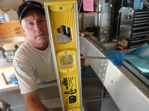

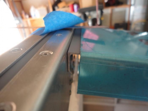

Brief Description:  roll bar
The roll bar is ready for installation. I clecoed the turtle deck skin back on and drilled the spacer for F732A. I next measured the lean back angle of the roll bar per the dimension on the side view on drawing 40. with this angle set , the F732A is too short. I will have to seek some advice before proceeding.
