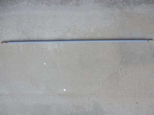

Brief Description:  F-789 push rod
I built and installed F789 elevator push rod. I did not find this in the manual. I just suspected it was time to do this. I found it very difficult to install. I had to drill a hole in F706 to get clearance. then installing the bolts and thin washers was a pain. once installed, I found that the rod was hitting the bottom of the opening at F705. VAF advice was to simply file the opening. Done!
