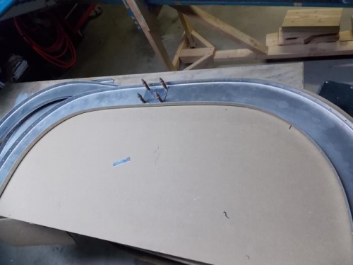

Brief Description:  cabin frame
I bought a piece of hardboard and layed out the dimensions for the roll bar. I spent a lot of time with a file to fit the rear channel to the proper height and width. I then measured, drilled and deburred all of the holes on the front and rear channels. I used a little tab that I made to center and space the holes.
