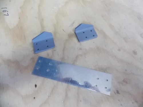

Brief Description:  rudder stops
I had made the rudder stops in advance, but the dimensions did not work out. They are too short. Since I had already drilled them to the fuselage I had to figure out a way to back drill the new stops. I got a thin piece of sheet and back drilled it to the old stops. Then I used those holes to back drill the new stops. I also worked on the F704 upright covers so I could prep them for paint.
rudder stops riveted
