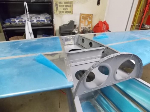

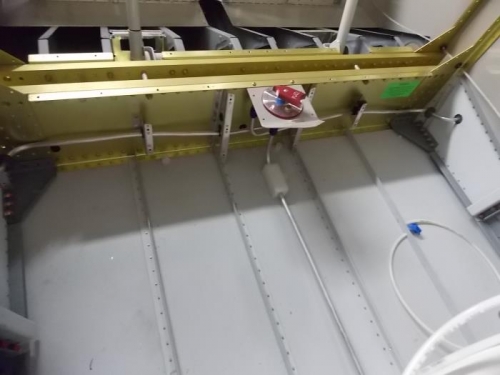

Brief Description:  Fuel Lines and horizontal stab
I finally finished the fuel lines and brake lines. I installed the elevators and drilled the horns. I must have measured the horizontal stab fifty times. I took the plunge and drilled the HS to the fuselage. I made the spacers and bolted the HS in. I got a scare when I remeasured the HS position. It was just the tape measure hung up. HS is on straight and angle of incedence is zero.
