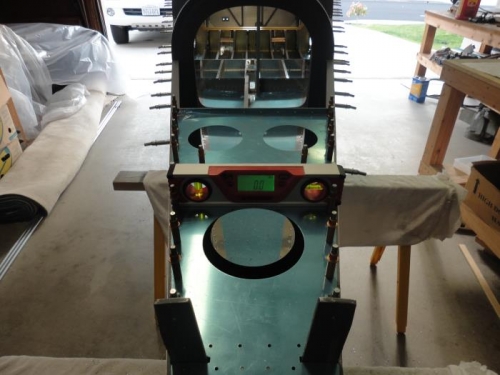

Date:  4-13-2014
Number of Hours:  3.50
Manual Reference:  8-10
Brief Description:  aft deck

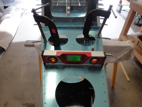

I leveled the fuselage and drilled the F-714 aft deck. I had read about the spacer at the 710 bulkhead on another builders website. This spacer is not mentioned in the manual. Also not mentioned are the 711D and 711E angle and spacer. I am not sure when these are supposed to be installed so I have not riveted anything yet. I think these pieces go in when the horizontal stab is installed. Another thing done out of sequence was the F-728A and B not riveted together before being installed in the fuselage. No problem, I was able to squeeze the rivets that hold 721-B.
before drilling
before drilling
after
after
