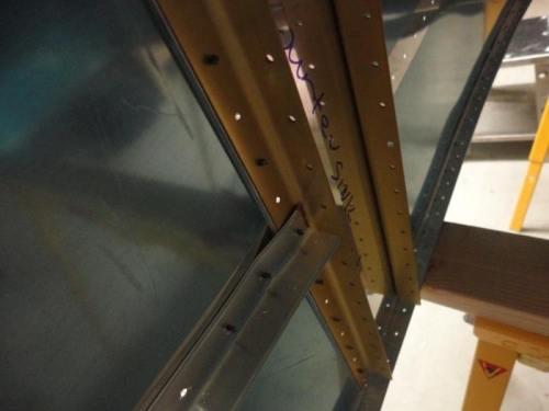

Brief Description:  F-719

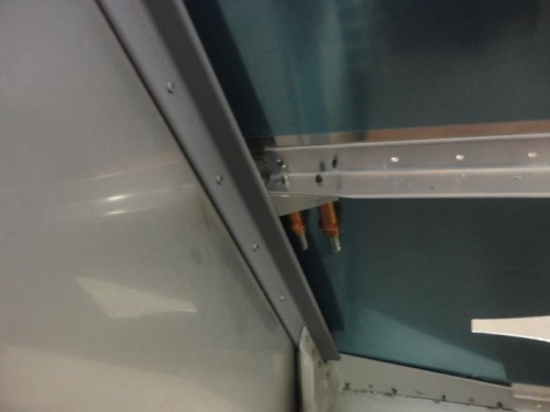

I did a lot of head scratching and test fitting to get the left F-719 in place. Now, how to drill the blind hole in the F719B clips. After seeing the solution on another builders website, I decided to make new clips without the third hole. Now I can just backdrill the firewall angle to the clip. It looks like the other end has as good of a fit as others I have seen. See pic #2
