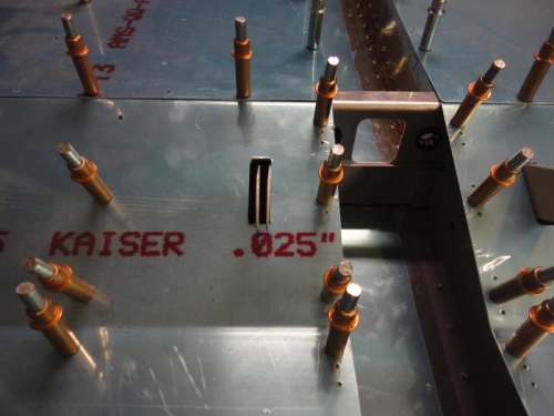

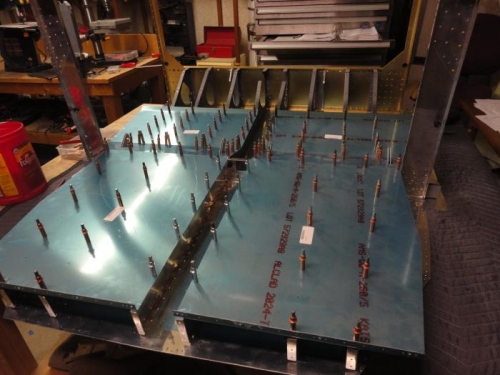

I had not done anything on the project all week. I needed Don to come over and help with riveting . We finished the bottom skin to the center section. Then we started lining up the floor panels. I had to make a modification where a seat rib meets F-705. I had done damage where a mistake led to an improperly drilled out rivet. I made a decision to drill the hole, which once held a rivet, to accept an AN3 bolt. I also had to open holes in F-742-R to clear the seatbelt mounts.The left side is fine.By the way, I went up to fly the club Archer last night, right at sunset. The last two landings it was getting dark. I have not flown at night in thirty years. I had forgotten how fun it can be.
