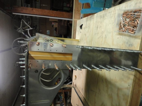

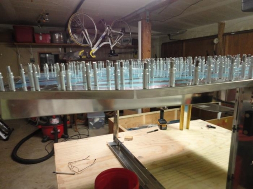

Finished drilling center section. Fitted and drilled F-623 and F704H. You have to assemble F704 again to get this done, so the close tolerance bolts went back into the freezer. Now the entire thing needs to come apart to be de-burred and dimpled.
