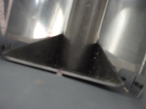

Brief Description:  tail spring mount
I can't seem to remember the last time i made foward progress on the project. This week I had received a new F-712 after waiting several weeks. I assembled the new F712 and clecoed it to the F-779 and F-711 with the WD 409 temp. bolted in. as you can see in the pictures both F712 and WD-409 seem to be out of square. I took the assembly apart and sure enough the flange on Wd-409 seems to have been welded on crooked. Also with F-712 and F-779 clecoed, it looks like the prepunched holes in F779 were punched out of sqaure. This results in the severe twist in F-712 as seen in the pics. Anyone else having this problem?
